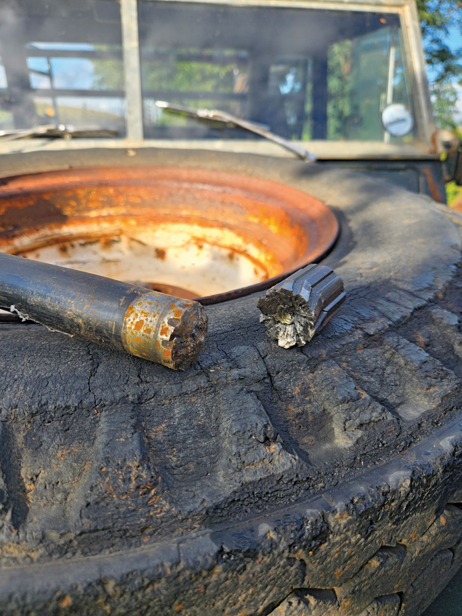

Side shaft – that’s what the axle shaft is called in South Africa. Since no shop in Lydenburg would agree to work on the old ‘69 Series bakkie, that left it up to me. It was maybe lucky that it broke at the spline, but it had swaged itself tight and had to be driven out of the differential.
Since the axles have to be slid out to remove the differential, how does one get the broken piece out? If the break is close enough to the hub, then you might stick a welding rod to the end and snag it. As there is a rod through the center of the diff, one cannot drive it out from the other hub with a long rod. Does one just turn the truck up on its side and shake until the broken axle falls out? It might be knowledge that could be crucial in the future.
Everett Stiles
Macon County, NC
[Series II-III Land Rovers have “floating” axle shafts that sit inside the rear axle casing. Breaks usually occur at the splines, either the wheel or differential end. If the break is at the differential end, or the axle piece is stuck at an angle in the casing, you can unbolt the prop shaft, unbolt and split the differential housing, remove the differential, and access the stuck piece. Make certain to clean any shards or swarf from the differential and housing before reassembly. When broken off at the hub end, weld a bolt to the end of the axle shaft and attach a slide hammer to the bolt, or a pry bar to lever against the bolt head to remove -ed.]

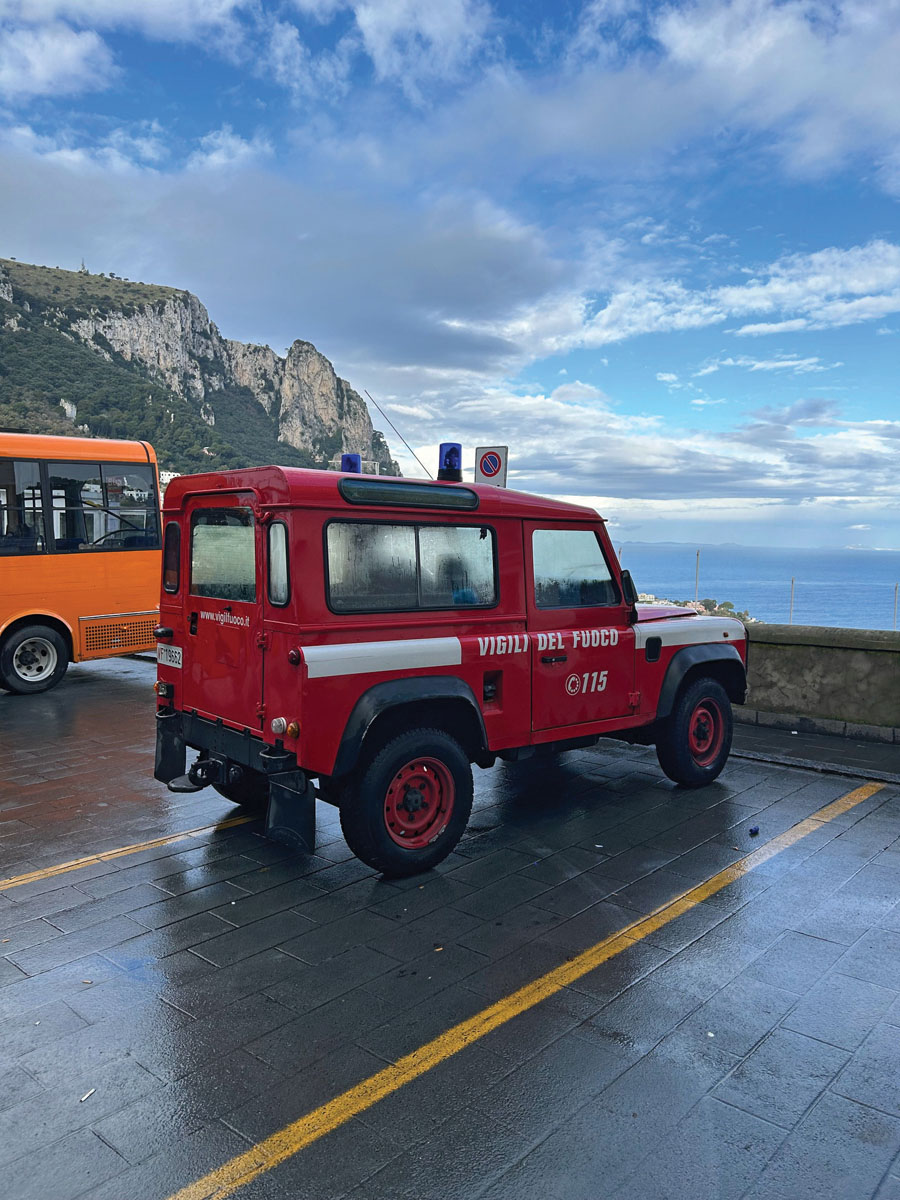

I saw this working fire truck while on the island of Capri, Italy, in February. Enjoy!
Jonas Bashaw
Cambridge, NY
[We have many first responders as readers, and we’re certain they’ll enjoy your photo -ed.]

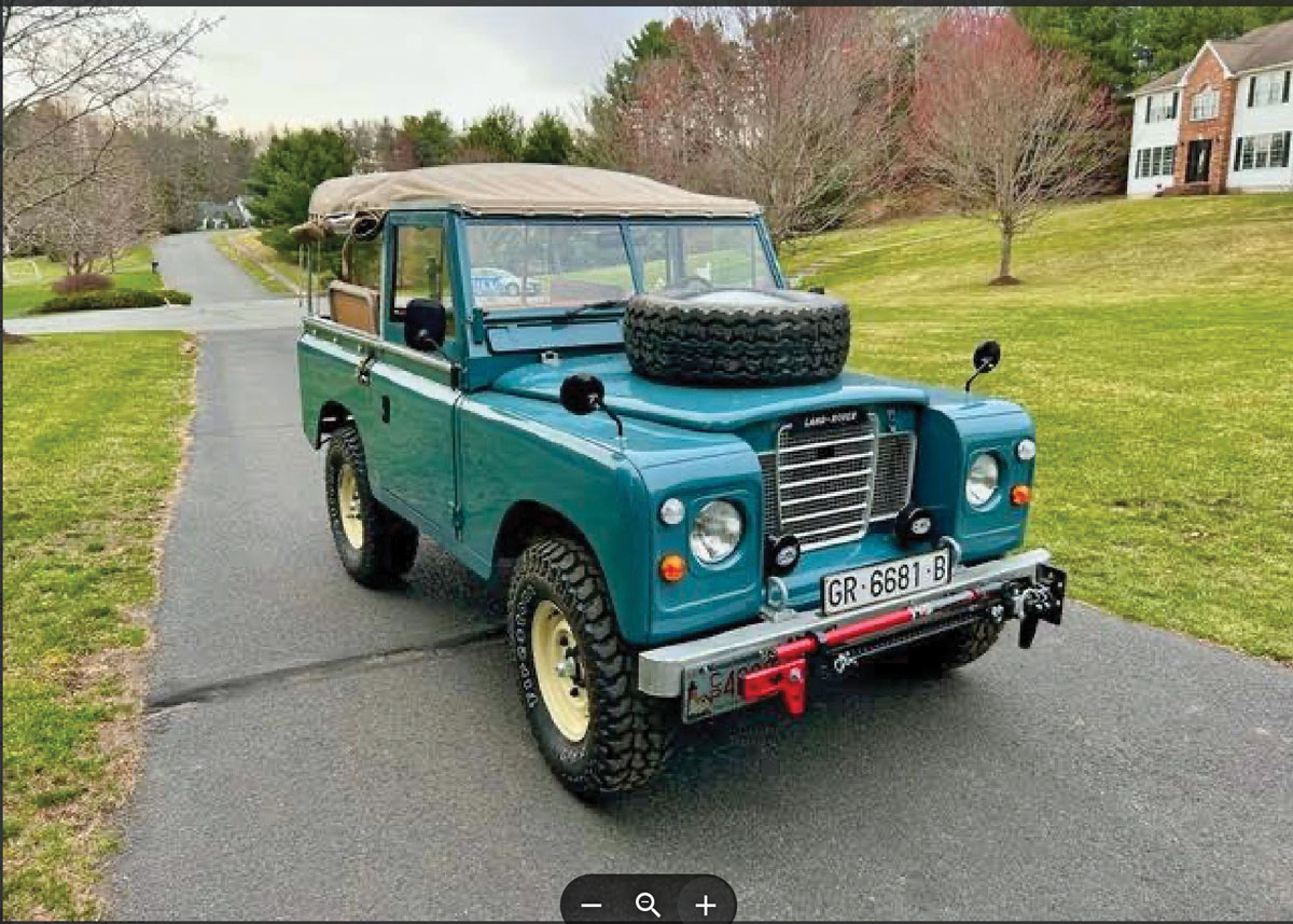

Shout out to Rob Smith, Erik Brennan and Pete Golovich at Rovers North for the parts assistance over the past year and a half on my ’74 Series III 88” Santana. After an educational, fulfilling, and at times frustrating galvanized frame swap & mechanical restoration, “Breezy” is now ready to assume coastal watch on the beaches of Chappaquiddick Island, MV.

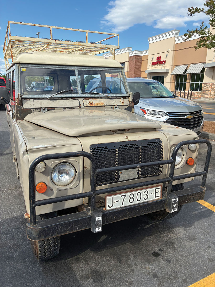

Imagine walking out of the grocery store and seeing this Series III Defender pull into a parking place. What a treat! The proud owner filled me in on all the details of his Santana Defender with a smile on his face. I asked for the ‘photo op’ which he graciously allowed. Made my day!
And I really enjoyed the OCTA Road Trip article in the last issue. What an amazing ten days it must have been for you. Thank you for sharing the experience, the thrill, and the OCTA!

[Your experience confirms that grocery shopping can be fun. We’re glad you enjoyed the OCTA article ed.]
