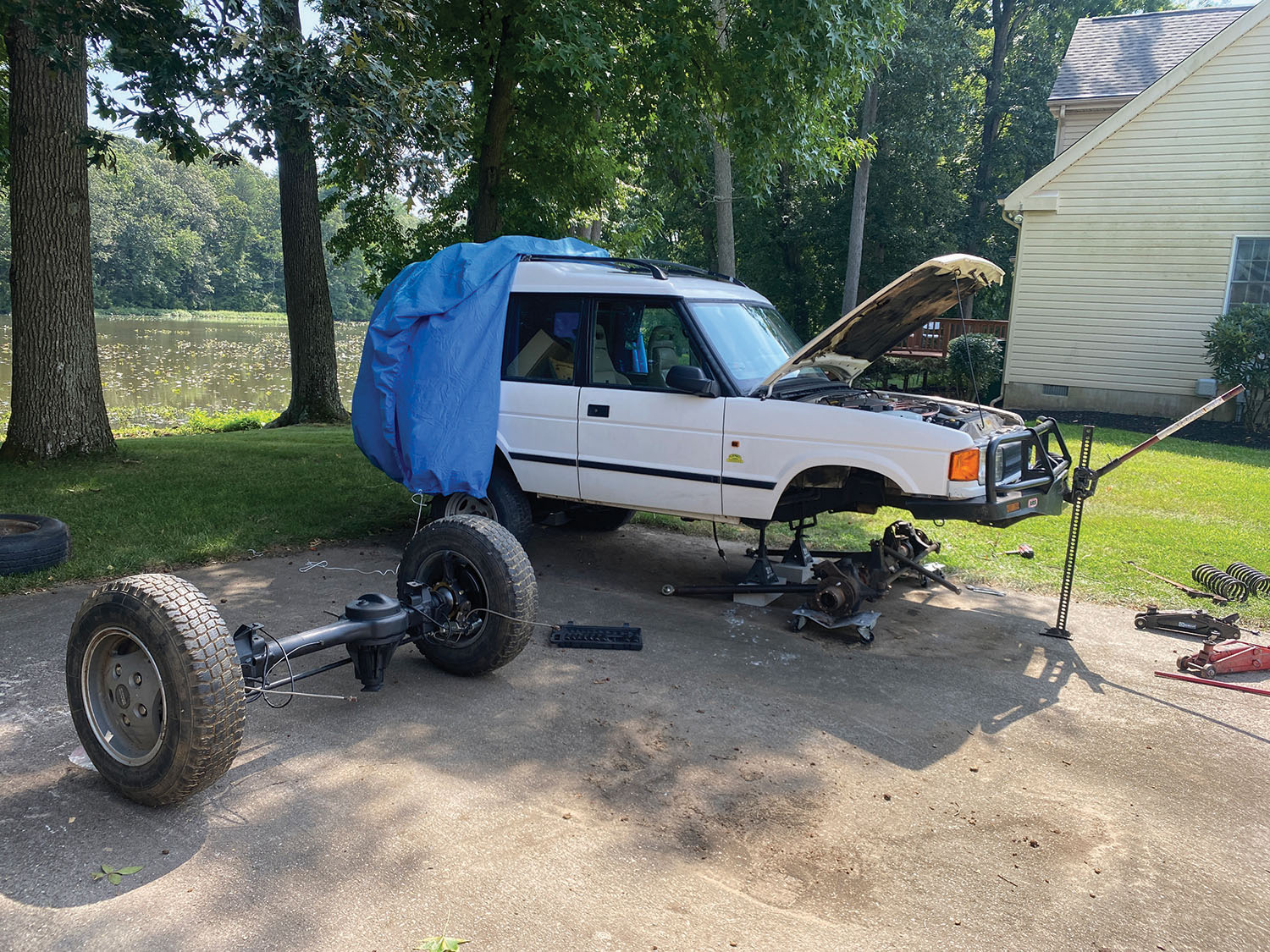

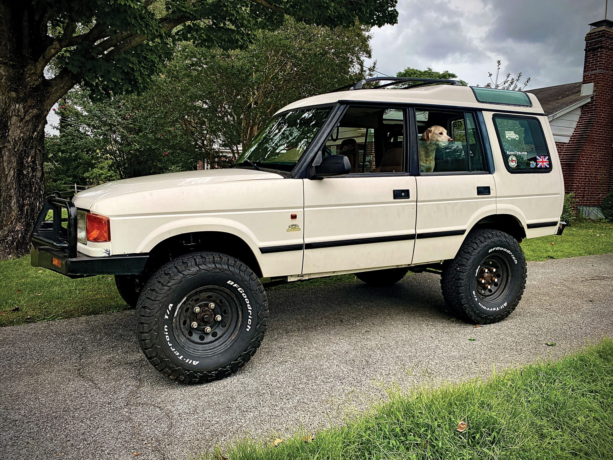

Our modest driveway in Delaware hosts this trio of vehicles:
  • ‘94 Alpine White Discovery I

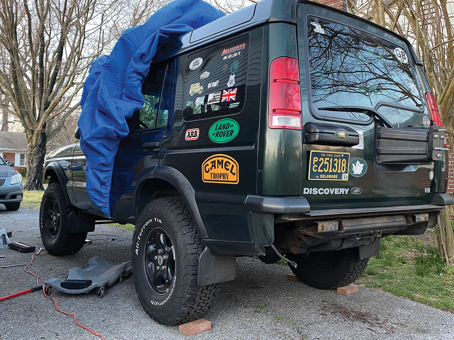

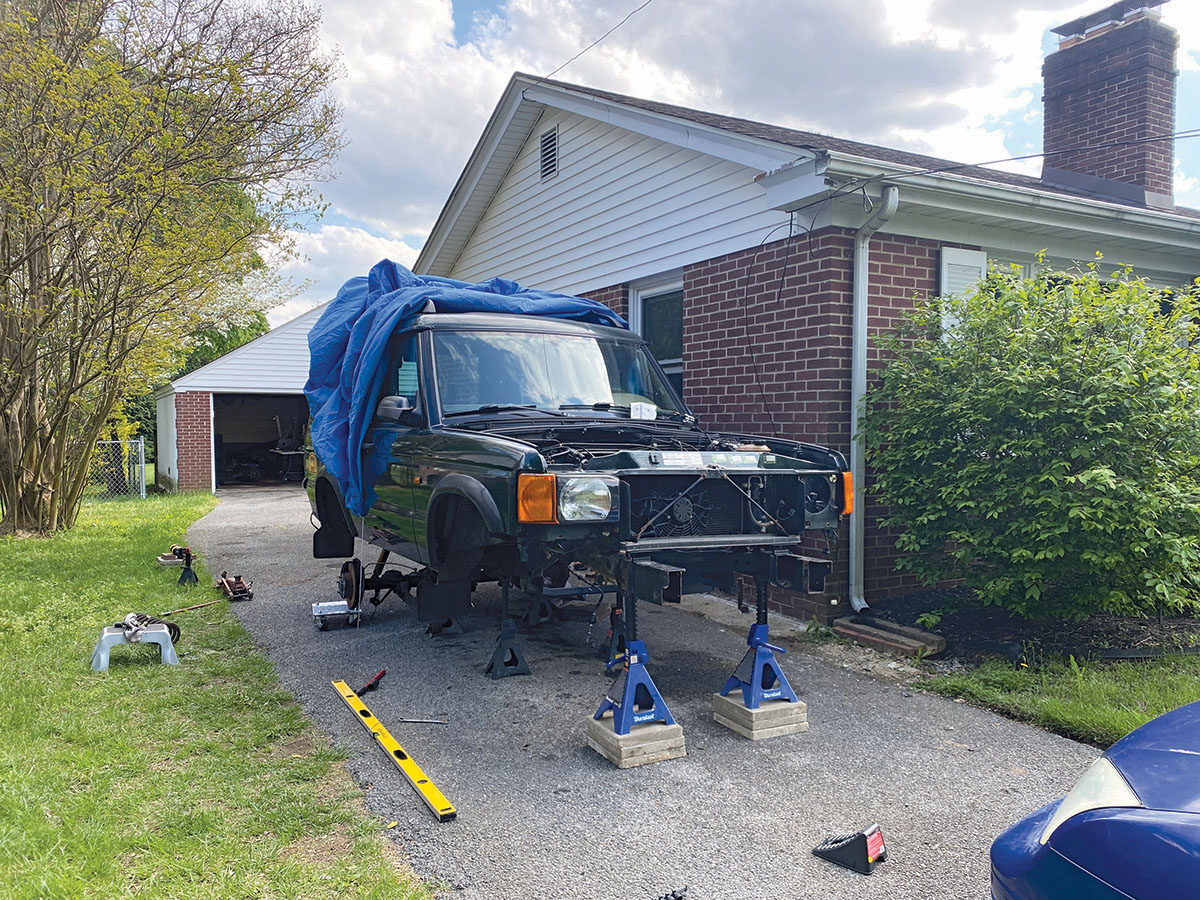

  • ‘00 Discovery II – or at least, the shell of one – resting on blocks, covered modestly in its blue cloth surgical gown
  • An ‘06 Ford Focus with 276,000 miles (currently the only drivable vehicle)
While our Land Rovers are more aspirational than operational, our humble Ford shows up faithfully every day without complaint — something the Land Rovers could stand to learn. I must credit my husband, Michael, an IT expert and commercial drone pilot, as well as a mechanic, dreamer, and the reason our household never breaks down completely. Michael’s steady wrench (and stubborn optimism) has never faltered. He comes by his Land Rover enthusiasm through his father, who gave him an ’88 Range Rover Classic SWB, (“My first head gasket,” Michael said.) He drove the Classic through high school in the early 2000s and really loved that vehicle.
IMG 6752

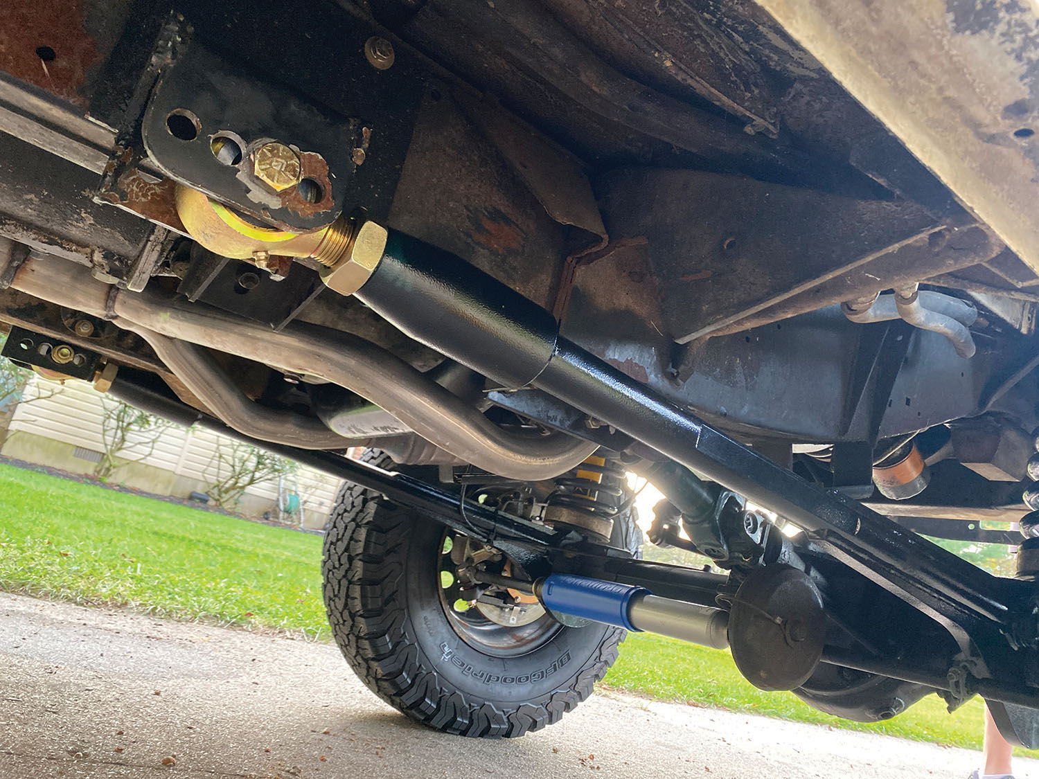

Our ’94 Discovery I came to us courtesy of Michael’s brother, Brian, who in 2006, moved from the East Coast to California. When their parents finally evicted it from their garage, my brother-in-law kitted it out for trail use: a 3-inch lift, 33” all terrain tires, a Dana 60 rear axle conversion and heavy-duty driveshafts. A rock crawler. When he gave up on the project and “gifted” it to Michael, we had to track down a salvaged stock front axle, which needed rebuilding of its own. Then Michael moved on to sourcing custom Johnny Joint radius arms from Adrenaline4x4.com in Australia just to reconnect to that stock axle.
XHJR1415
After flushing fluids, replacing hoses and bolting on a fresh exhaust, Michael coaxed the Discovery back to life — the first time it had run in 15 years. For one moment, it was a live Land Rover again.
Of course, the comeback didn’t last long.
Soon after passing inspection and its official debut on our insurance policy, the distributor springs failed suddenly; there went the timing. While replacing the distributor, Michael also installed new spark plugs and wires. That left two major if unrelated issues: electrical gremlins that had taken up residence, and a front-end death wobble.
IMG 7454
The electrical problems included an erratic temperature gauge that would soar and plummet like a carnival ride, irrespective of the actual engine temperature. Activating any accessory systems would set the whole drama in motion. Rear windows that would not activate upon command turned out to be broken solder joints on corroded circuit boards. The deeper Michael dug, the more elusive the solution. Bad grounds? Failing wiring? Faulty relays? Electrical issues had to wait until he sorted out the front axle death wobble. Incorrect front axle geometry had worn out vital suspension parts, so the to-do list now reads: remove the front axle, examine and/or adjust the swivel balls, overhaul the steering system, replace worn steering arms and perform the necessary wheel alignments.
IMG E7385
After hours of diagnosis — and a few unnecessary (and costly) part swaps – we settled on a temporary fix: chock the rear wheels and leave the Discovery stationary. It’s the deflating moment every Land Rover enthusiast knows too well. That maddening dance of progress and breakdown, hope and setback. You’re so close — and then, as if on cue, something snaps, leaks or shorts. It’s a predictable plotline, a tiring narrative. But we keep reading it. Because somehow, even with all the hassle and heartache, we still believe the next chapter might end with a smooth ride.

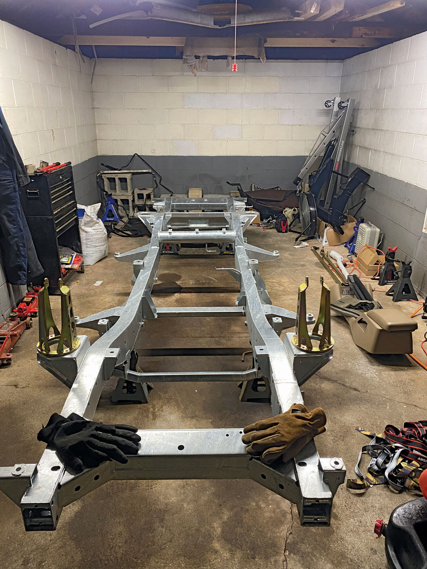

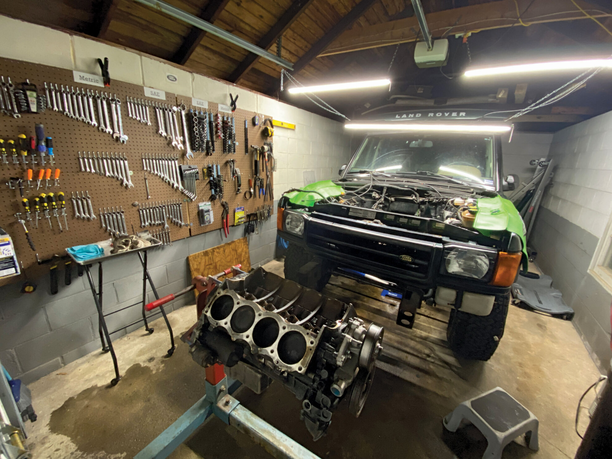

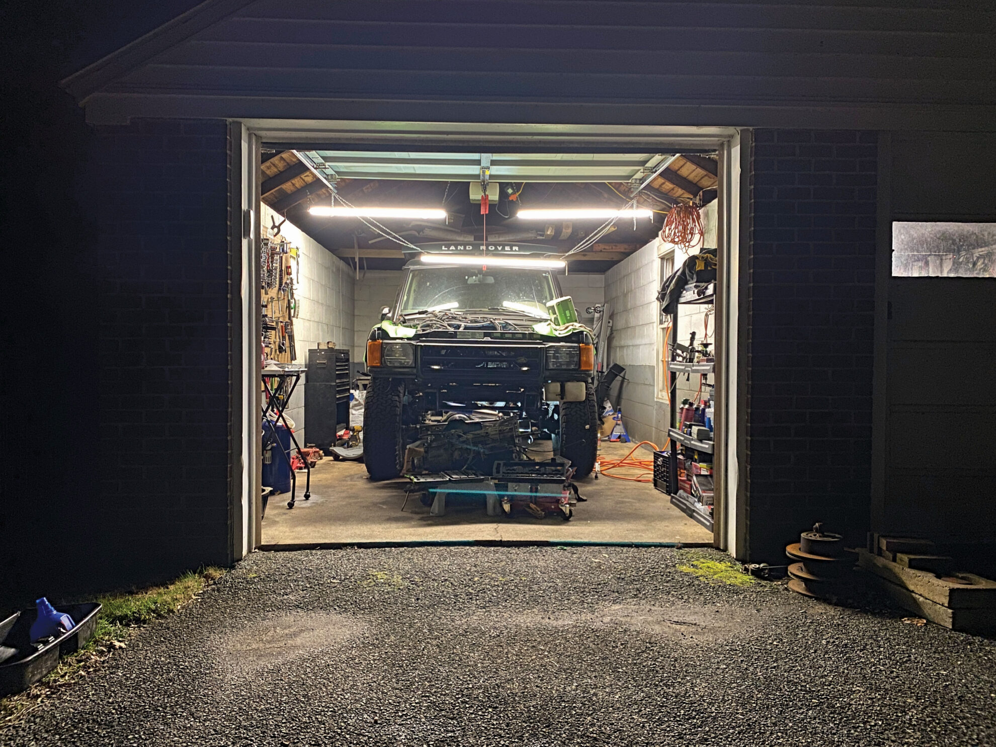

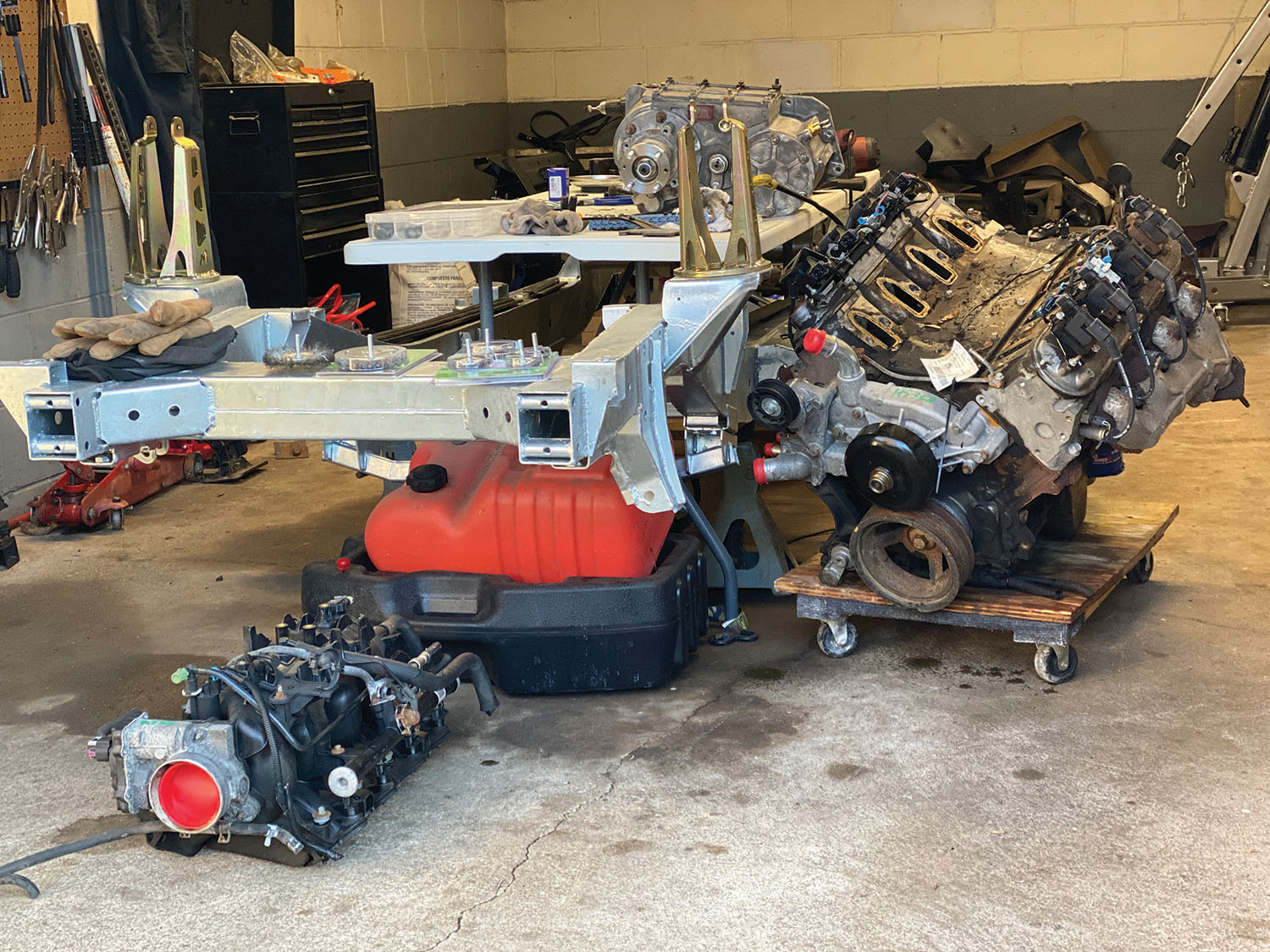

Lastly, closest to the garage — and closest to my husband’s heart — sits a 2000 Discovery II, owned by Michael’s father from new when Michael was 12 years old. Or more precisely, the shell of a Discovery II, perched precariously on cement blocks. Michael has scattered its parts across two bays of the garage, tucked the headliner and hood into the rafters, while the seats and carpeting have found a temporary home in a wing of the basement. He’s planning a full frame-off rebuild, complete with a bigger crate engine.
IMG 5359
Screenshot

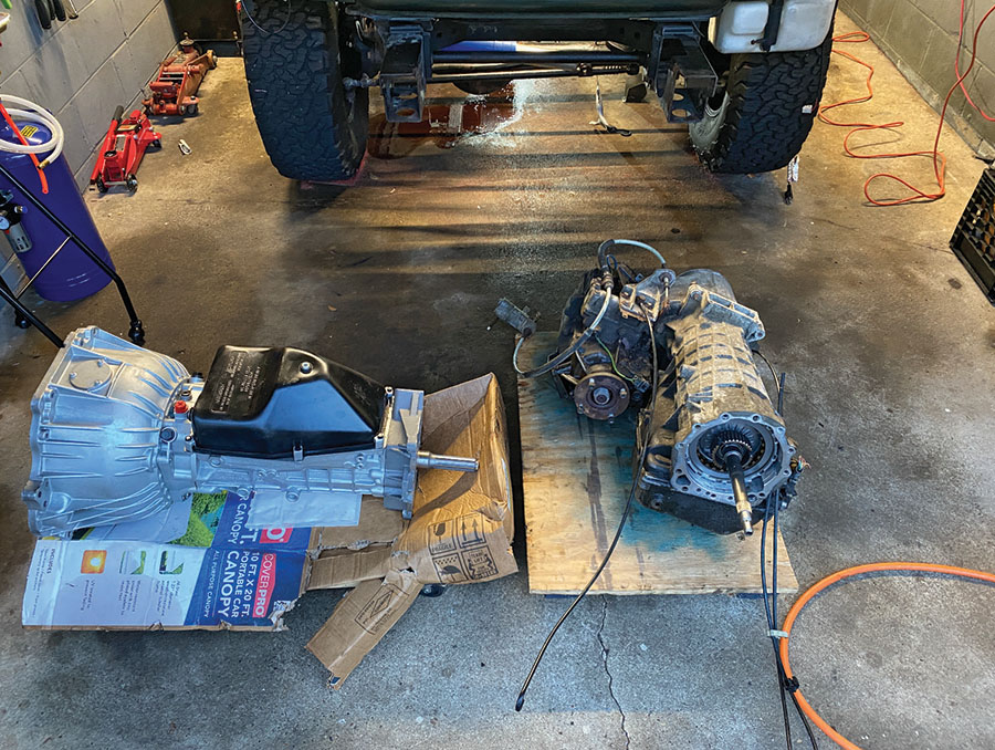

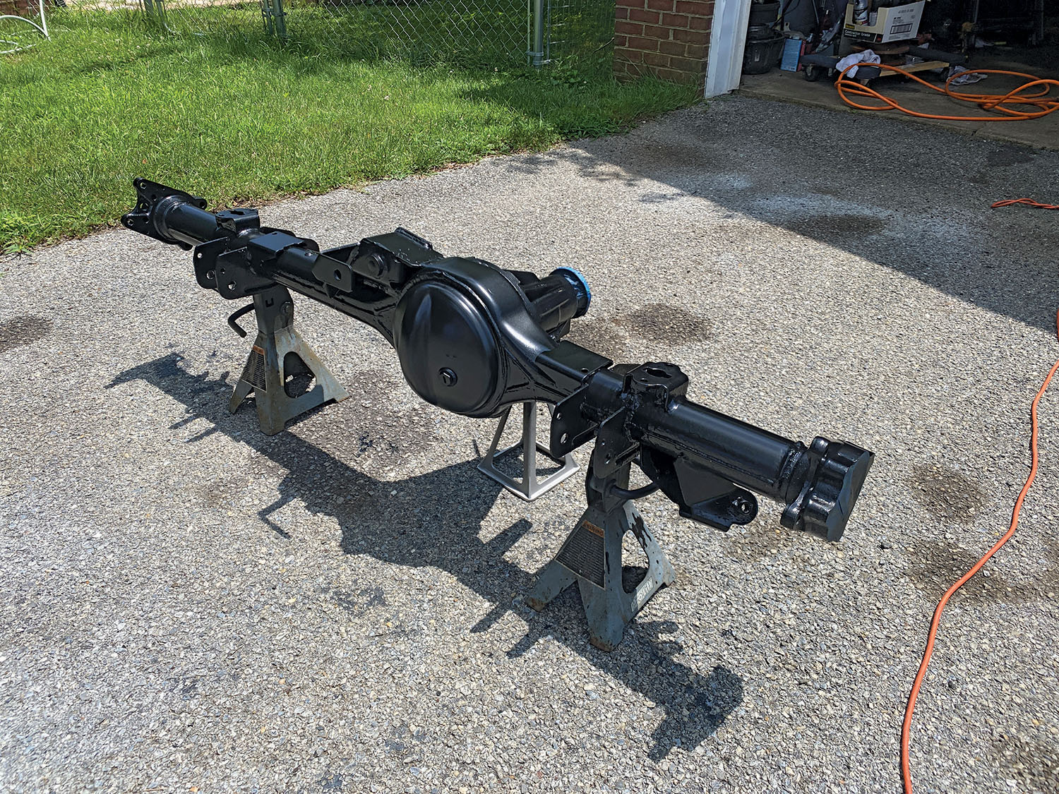

The new engine will pair with a heavy-duty Ashcroft HP22 transmission, equipped with a larger torque converter to handle the engine’s added output. That will mount to a rebuilt LT230 transfer case, installed onto a galvanized frame. Rebuilding both axles comes next. Once completed, the plan is to install a four-inch Rovertym suspension. (Yes, we’re aware that anything over two inches raises eyebrows — and center of gravity — on the road.) With that, Michael will have a rolling chassis, ready to accept the drivetrain.
IMG 5211
The old body will be reunited with the new, fully built chassis – possibly by gantry crane, since we lack a full shop. Other upgrades will include custom exhaust routing to maintain underbody clearance and retrofitting the fuel system. At some point, in our wildest dreams, we’ll add front and rear differential lockers, an auxiliary power setup in the rear, a rooftop tent, a batwing awning and a winch up front.
