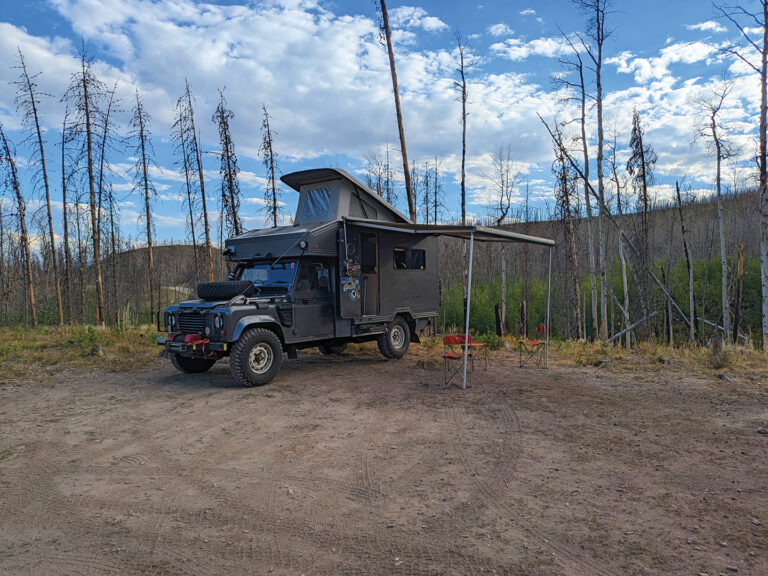

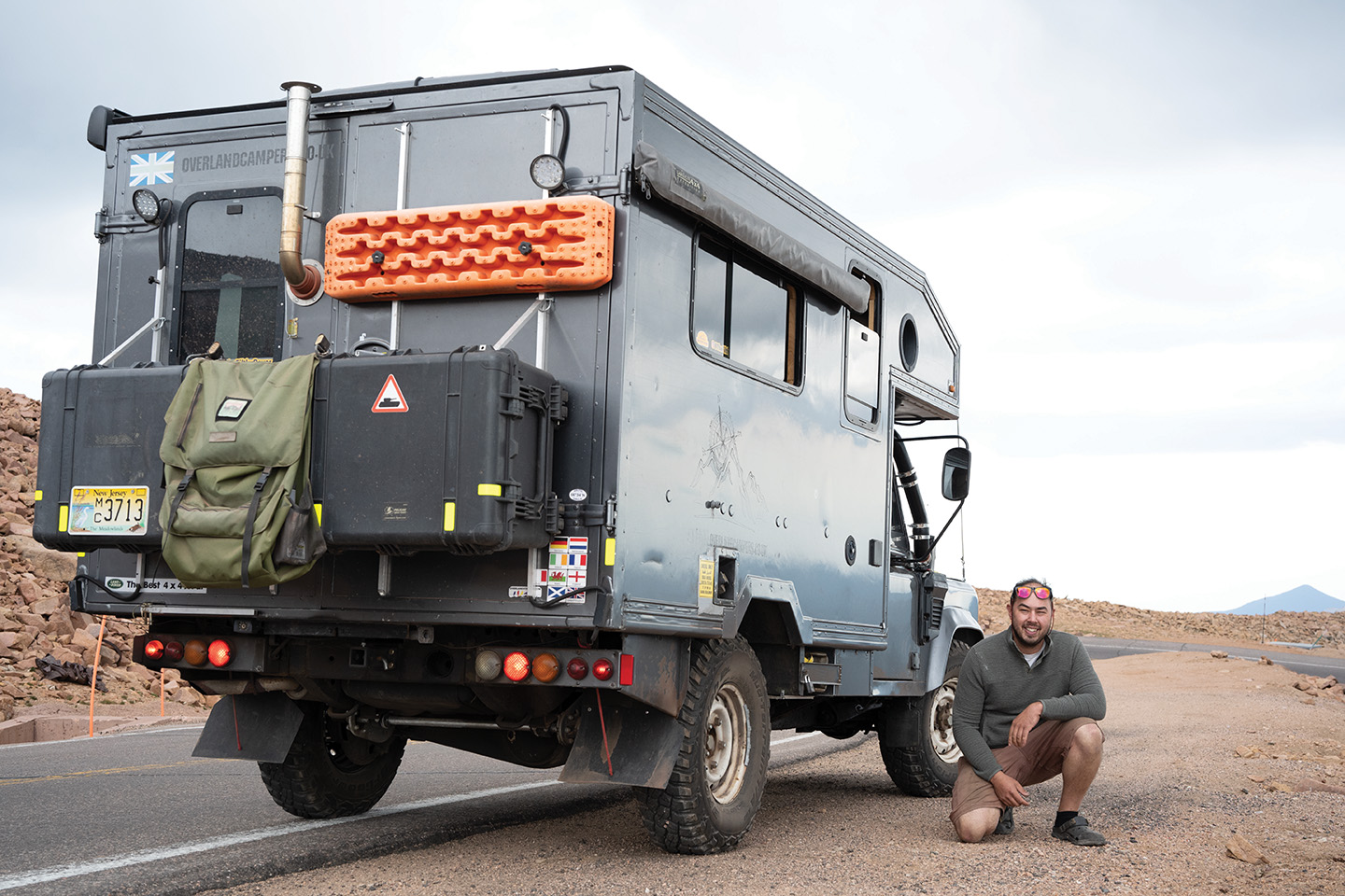

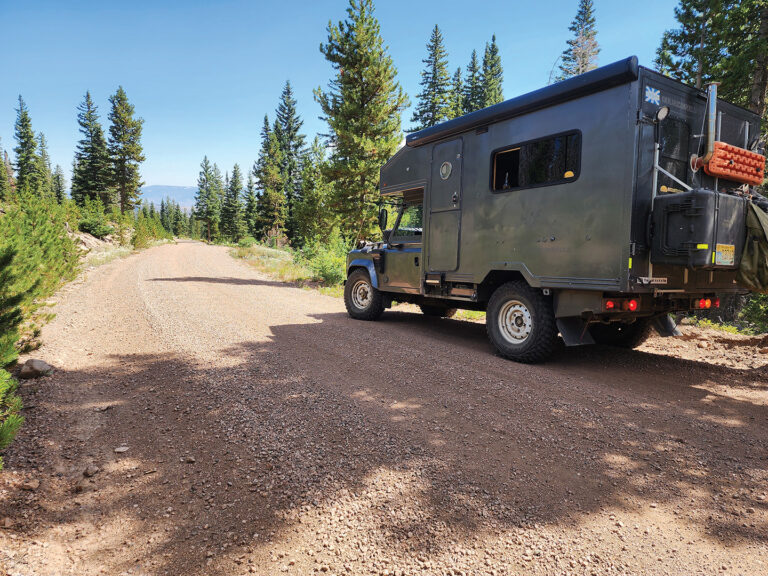

The Foremans have embraced Land Rovers for many years (an ’08 Range Rover L322 and a ’16 Range Rover L405 are their latest), and their choice of this ’97 Defender “Pulse” 130 with its 300 Tdi seemed perfect to them. “We actually read about the Pulse variant in Rovers Magazine. Coil springs appealed to me, as did the beefed up XD chassis, 300Tdi, Wolf axles, permanent 4-wheel drive with the center differential lock and 4-wheel disc brakes. The alloy box is made by Marshall, engineered from scratch to be light, strong and repairable.” Their search seemed interminable but they’re thrilled with their find.

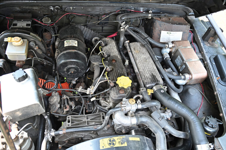

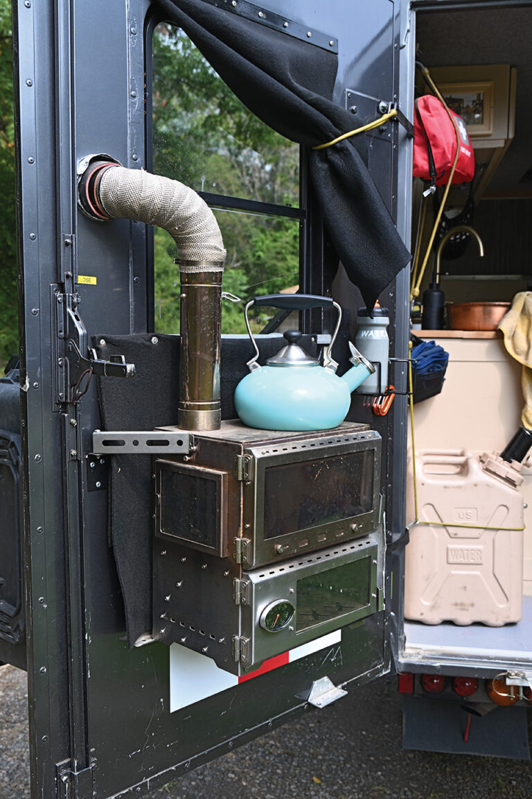

Upon receiving “Lance,” Michael refreshed the 300Tdi with new silicone cooling and heater hoses, installed a new brass radiator/intercooler and larger transmission cooler, a finned sump for the transfer case, an alloy coolant tank and new fan clutch. For the winch, he chose a PTO-driven Superwinch, and included all new wheel bearings. He converted the stove to run on smaller, easier-to-fill, propane tanks and replaced the water heater tank with a heat exchanger “that works far better than we expected. The stainless steel wood stove doubles as a baking oven. A 500w inverter, 24v to 12v converter and 2x 100amp-hour lithium batteries supply our living-quarter needs for now.”

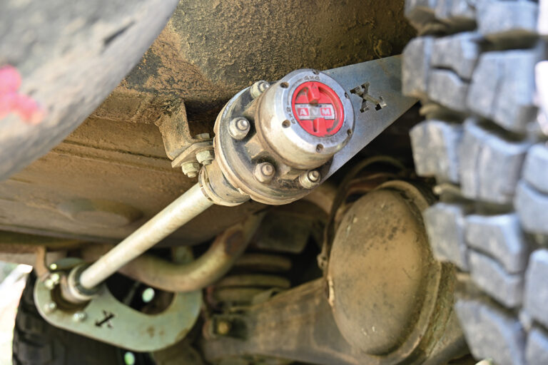

Michael noted, “The X-Deflex rear swaybar is one of our favorite handling upgrades and is always disengaged for gravel roads and gnarly trails. The 255/85/16” BFG MTs feel a bit heavy and have changed the gearing, so we might go back to 265s to regain some of the ‘pep.’ Looking ahead, I’ll have to replace the shocks and suspension bushings. I’d like to install front and rear diff locks and maybe consider a Getrag MT82 6-speed transmission as pulling away on an incline in high range is tricky — flicking between low range and high ranges in traffic is not fun. That upgrade would allow me to change the final drive ratio also.”

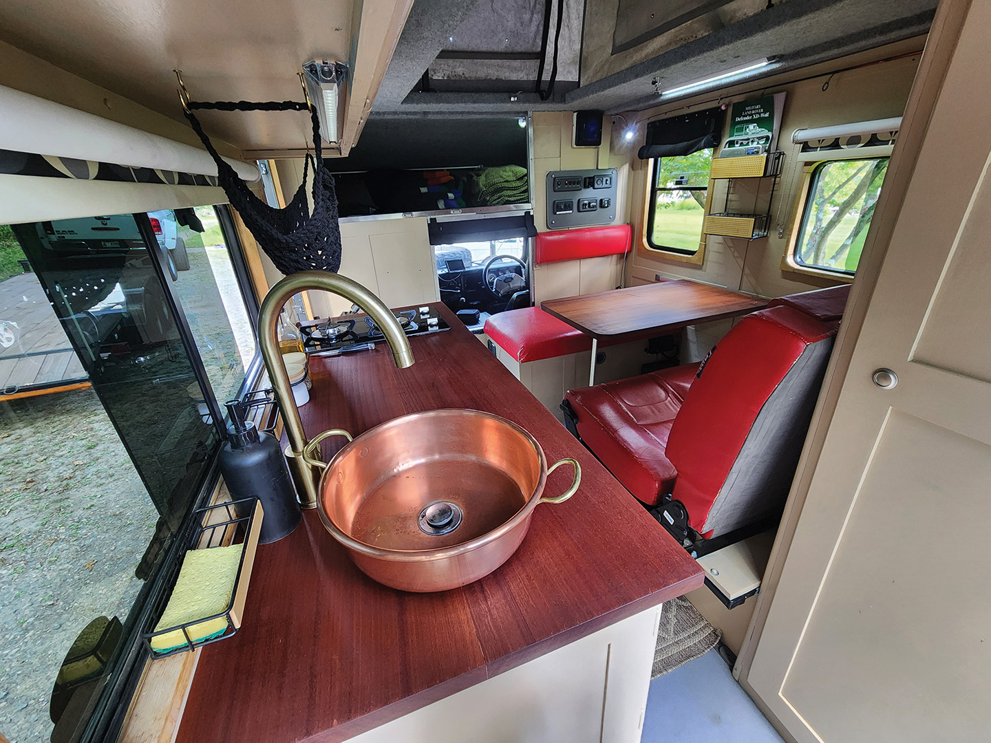

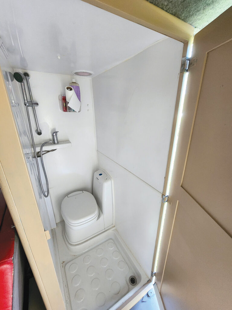

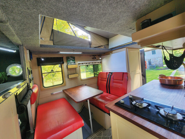

“Lance” has a pop-up roof large enough to sleep two adults although the Foremans find that they elevate the roof more for headroom than sleeping. The kitchen consists of a medium-size refrigerator, a two-burner propane stove, a stand-up shower room and toilet. The dinette converts into a sleeping area, which has become their preferred arrangement. There is an overhead area designed for a children’s sleeping area; for Micheal and Jennie, it’s more suited for clothing storage.
