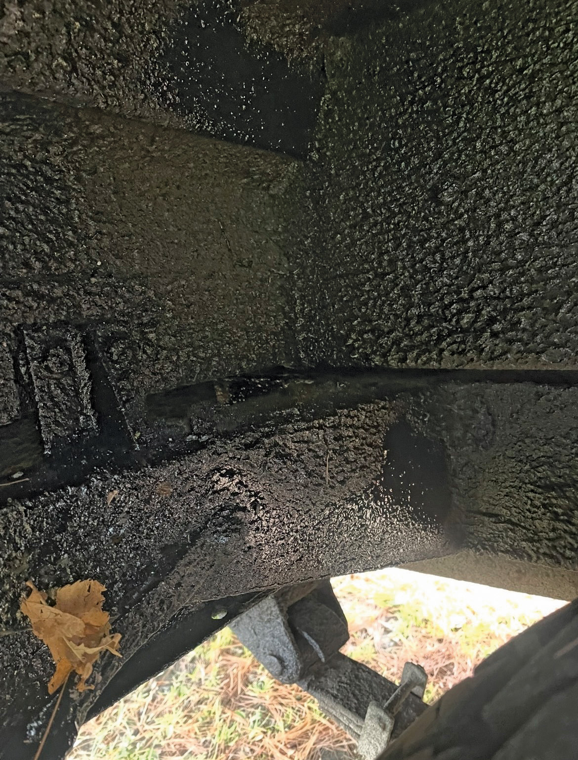

When Spring arrives in much of rest of the USA, it’s still winter in Vermont. As a long-time Land Rover tech and restorer, my clients and friends often ask me, “What’s the best way to protect my Rover from the harsh New England winter?” I loudly proclaim, “Don’t drive it!” If you must drive it (as I do with mine), at least get some kind of protective undercoating. I’m a fan of Waxoyl or New Hampshire Undercoating Oil products. A less robust product is Fluid Film. To be most effective, any spray product demands a thorough cleaning and drying of the underside of the vehicle before application.
